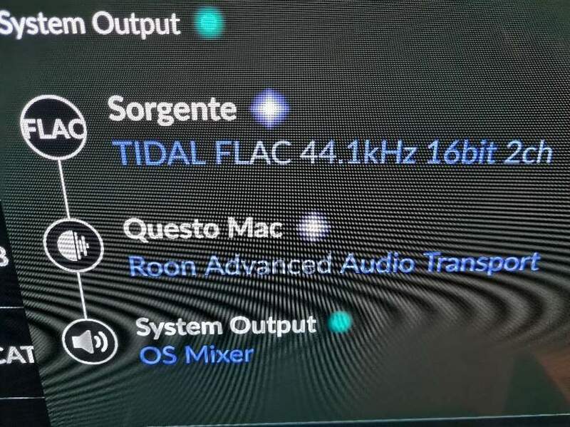

È normale che sia verde, usi il mixer audio del sistema operativo.
Per essere blu devi avere qualche endpoint certificato da Roon collegato .
Tu non hai niente se non il Mac.
Guglando:
Bright Purple: Lossless
Lossless is exactly what the name implies: that the stream is going from the file to the device without being modified.
Shining Blue: Enhanced
Enhanced signal paths are indicated by a shining blue light. This means that Roon is performing some signal processing steps on the audio because you asked for them. The most common reason for a blue light is that features like Volume Leveling or DSP Engine are in use.
  Green: High Quality
Generally Signal Path will show the green light for OS Mixer outputs, as well as things like conversions for compatibility, and DSP volume. More on that in the examples at the end of this article.

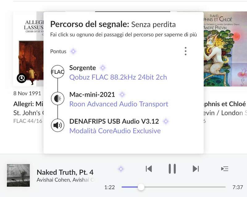

Il tuo Denafrips é l’endpoint.
Il mio Denafrips è un dac, il Mac mini core e endpoint assieme.
”The roon core can also be an end point as well where you hook your dac to the usb or optical output of your core. For best sound quality it’s recommended to separate your end point.”
https://melius.club/topic/7177-roon-e-uscita-audio/#findComment-392166
Nonostante Roon consigli sempre di separarli non c’è nessun problema a lasciar convivere core ed endpoint sulla stessa macchina … sono andato avanti per anni così ed il suono era comunque molto buono! Da me si sono separati quando ho messo un dac con ingresso ethernet
