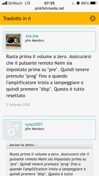

Turn volume to zero first. Make sure your Naim remote button is set to “pre” first. Then hold down “prog” until the amp starts flashing and then press “disp”. That’s it reset
