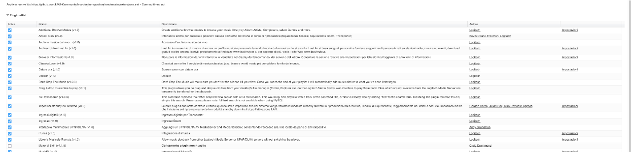

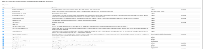

fiorinis Inviato 16 Gennaio 2024 Condividi Inviato 16 Gennaio 2024 @max grazie ma temo che il problema sia che la libreria OpenSSL non sia aggiornata. ho provato ad installare manualmente i file (ad es. ms-material-4.1.5.zip) in Library/Application Support/Squeezebox/Plugins (come suggerito in https://forums.slimdevices.com/forum/user-forums/logitech-media-server/105068-manually-installing-plugin-zips al post 7) e riavviato il server. vedo il plugin tra quelli attivi ma mi dice caricamento non riuscito. nel file di log mi dice [24-01-16 18:33:30.5672] Slim::bootstrap::tryModuleLoad (286) Warning: Module [Plugins::MaterialSkin::Plugin] failed to load: Can't locate Plugins/MaterialSkin/Plugin.pm in @INC (you may need to install the Plugins::MaterialSkin::Plugin module) (@INC contains: /Users/mac/Library/Caches/Squeezebox/InstalledPlugins /Library/PreferencePanes/Squeezebox.prefPane/Contents/server/CPAN/arch/5.18/darwin-thread-multi-2level /Library/PreferencePanes/Squeezebox.prefPane/Contents/server/CPAN/arch/5.18/darwin-thread-multi-2level/auto /Library/PreferencePanes/Squeezebox.prefPane/Contents/server/CPAN/arch/5.18.2/darwin-thread-multi-2level /Library/PreferencePanes/Squeezebox.prefPane/Contents/server/CPAN/arch/5.18.2/darwin-thread-multi-2level/auto /Library/PreferencePanes/Squeezebox.prefPane/Contents/server/CPAN/arch/5.18/darwin-thread-multi-2level /Library/PreferencePanes/Squeezebox.prefPane/Contents/server/CPAN/arch/5.18/darwin-thread-multi-2level/auto /Library/PreferencePanes/Squeezebox.prefPane/Contents/server/CPAN/arch/darwin-thread-multi-2level /Library/PreferencePanes/Squeezebox.prefPane/Contents/server/CPAN/arch/5.18 /Library/PreferencePanes/Squeezebox.prefPane/Contents/server/lib /Library/PreferencePanes/Squeezebox.prefPane/Contents/server/CPAN /Library/PreferencePanes/Squeezebox.prefPane/Contents/server /Library/Application Support/Squeezebox /Users/mac/Library/Application Support/Squeezebox /Library/PreferencePanes/Squeezebox.prefPane/Contents/server /Library/PreferencePanes/Squeezebox.prefPane/Contents/server/CPAN/arch/5.18/darwin-thread-multi-2level /Library/PreferencePanes/Squeezebox.prefPane/Contents/server/CPAN/arch/5.18/darwin-thread-multi-2level/auto /Library/PreferencePanes/Squeezebox.prefPane/Contents/server/CPAN/arch/5.18.2/darwin-thread-multi-2level /Library/PreferencePanes/Squeezebox.prefPane/Contents/server/CPAN/arch/5.18.2/darwin-thread-multi-2level/auto /Library/PreferencePanes/Squeezebox.prefPane/Contents/server/CPAN/arch/darwin-thread-multi-2level /Library/PreferencePanes/Squeezebox.prefPane/Contents/server/CPAN/arch/5.18 /Library/PreferencePanes/Squeezebox.prefPane/Contents/server/lib /Library/PreferencePanes/Squeezebox.prefPane/Contents/server/CPAN /Library/Application Support/Squeezebox /Users/mac/Library/Application Support/Squeezebox /Library/Perl/5.18/darwin-thread-multi-2level /Library/Perl/5.18 /Network/Library/Perl/5.18/darwin-thread-multi-2level /Network/Library/Perl/5.18 /Library/Perl/Updates/5.18.2 /System/Library/Perl/5.18/darwin-thread-multi-2level /System/Library/Perl/5.18 /System/Library/Perl/Extras/5.18/darwin-thread-multi-2level /System/Library/Perl/Extras/5.18 .) at (eval 1087) line 1. BEGIN failed--compilation aborted at (eval 1087) line 1. ma le cartelle Library/Caches/Squeezebox/InstalledPlugins e /Library/PreferencePanes/Squeezebox.prefPane/ sono vuote, non contengono neanche file relativi ai plugin installati. Link al commento https://melius.club/topic/14418-client-per-daphile/page/2/#findComment-1076334 Condividi su altri siti Altre opzioni di condivisione...
