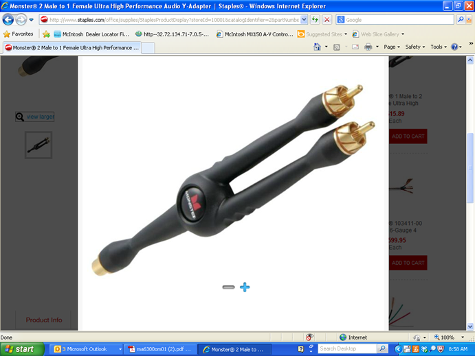

tempo fa ho mandato una mail al servizio assistenza McIntosh per collegare il mio subwoofer Velodyne al mio MA5200.
Di seguito la risposta:
How to connect a SUB to integrated amp with no extra preamp out:
Assuming the SUB has left and right RCA input jacks:
Remove the jumpers between MAINOUT and POWER AMP IN from the back of the MA6300.
Insert a pair of Y jacks like this:
Two “ Y” jacks with 2 Male and one female is ideal, put the 2 male ends in where you removed the jumper, between MAINOUT and POWER AMP IN, one on the left and one on the right.
This will leave a pair of RCA female jacks, one left and one right, from which you can patch to the SUBWOOFERs input.
All'epoca avevo le Heresy, che avevano bisogno di un subwoofer: il collegamento suggerito funzionò perfettamente.
