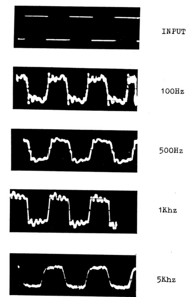

Square Wave Performance
The square wave performance of the LFT-8b is shown below at different frequencies. Measurements were made in a normal listening room, and the microphone position was optimized for each frequency. In order for a loudspeaker to reproduce a square wave, it must have good frequency response, phase response, impulse response and transient response. We only know of a handful of speakers that can reproduce square waves, and most speaker companies do not want to discuss square wave performance at all.

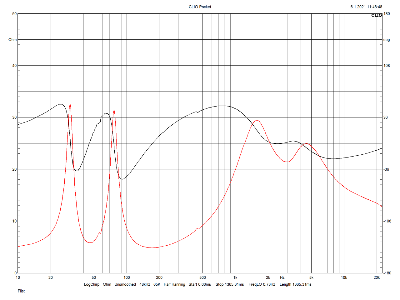

LFT-8b Impedance Curves
The LFT-8b impedance is shown below. The impedance generally averages much higher than 8 ohms. This means that the speaker does not require a high current amplifier. Because of the lower than average efficiency you will still need an amplifier with a fairly high power rating (75 watts per channel or more). If an amplifier clips into the speaker it will probably be due to a voltage limitation.
