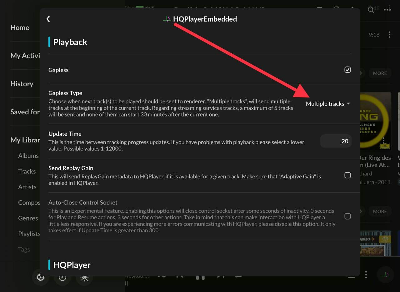

Questo è un messaggio popolare. stefano_mbp Inviato 9 Luglio Questo è un messaggio popolare. Inviato 9 Luglio JPLAY 1.4.3 is out. Changelog: Direct Disk Playback for HQPlayer and MinimServer: when HQPlayer Desktop and MinimServer share the same machine, JPLAY can send the local file path to HQPlayer for direct-from-disk playback. Improved HQPlayer playback: JPLAY can now send multiple upcoming tracks to HQPlayer at once, for smoother transitions. Queue Radio modes: more control over how it picks what plays next. Bug fixes and performance improvements. . per il punto 2 occorre configurare opportunamente il device audio HQPlayer in JPlay 3
