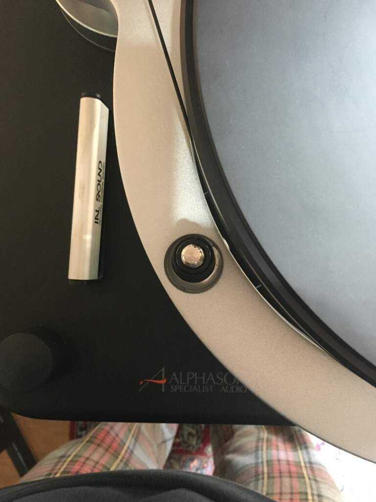

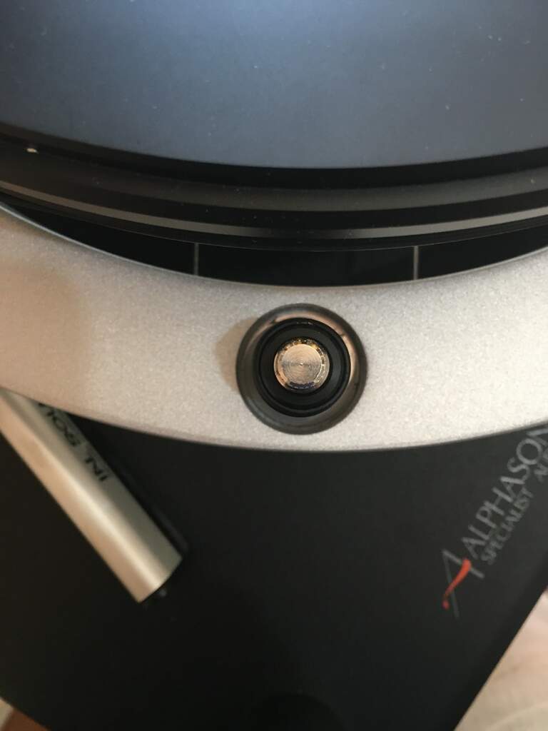

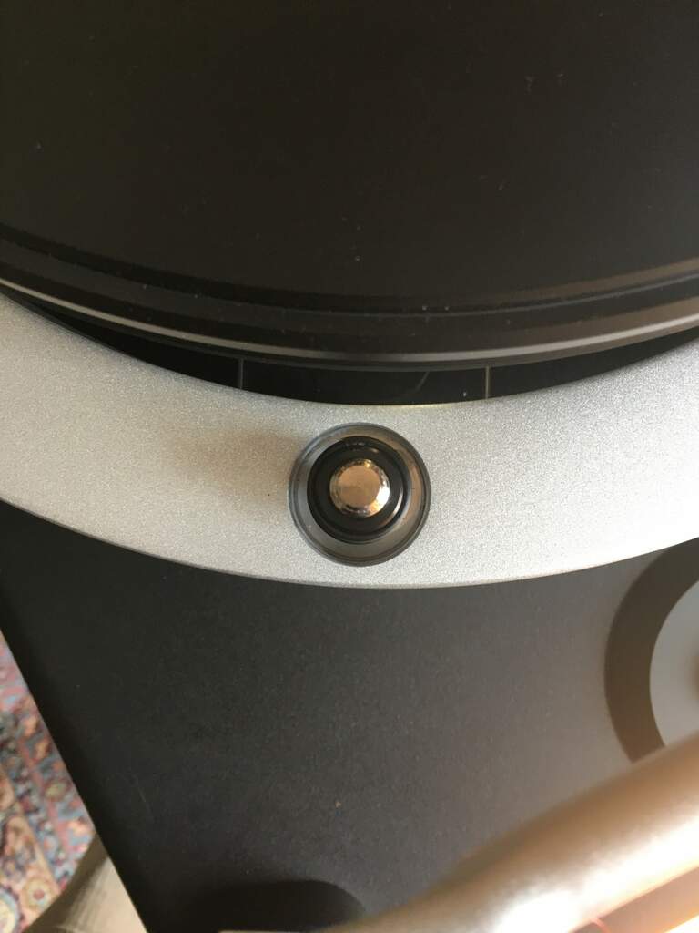

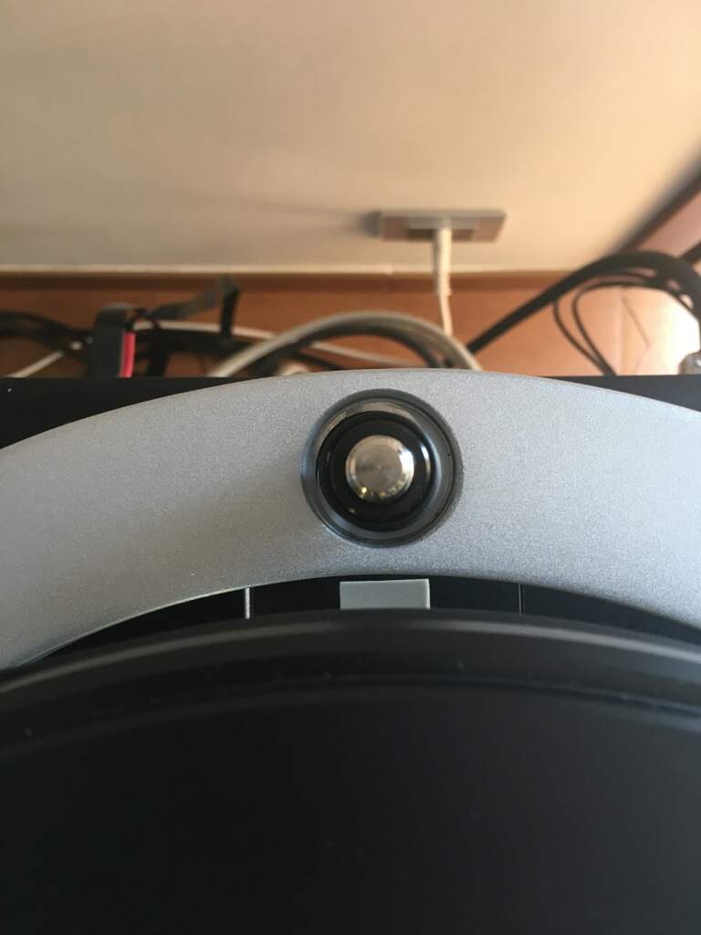

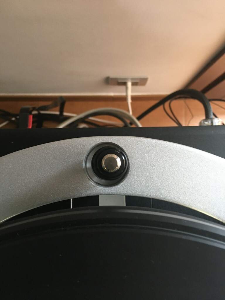

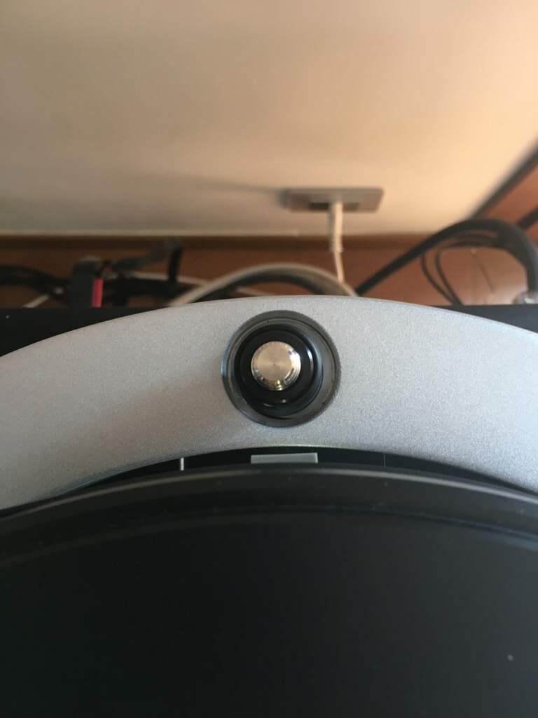

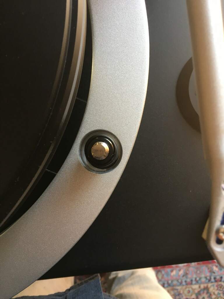

ilbiffo Inviato 15 Febbraio 2023 Condividi Inviato 15 Febbraio 2023 @prometheus Questo è quello che mi hanno risposto: Good Morning Thanks for your e-mail. Check that the spring bases are fully fitted into the counterbored holes in the underside of the chassis. Check that the gap between the underside of the chassis and the felt washer sat on the plinth is no more than 1-2 mm. After you have arranged this height at all 3 positioned and have ensured that the deck is level, i.e. level the plinth using the feet threaded to the legs and then the chassis/platter by slight adjustment of the suspension. Once this is done it is important that the coils of the springs are ' concentric' with the hole in the chassis this achieve by rotating the spring , you will need to do each spring at least twice ensuring that the motor isn't in contact with the ear of the chassis. I hope this makes sense to you. Regards Steve Rowland Tuttavia nelle istruzioni "Gyro SE MK II Pictorial Setup Instructions "di un modello non recente al punto 17 dice: 17. Although not absolutely necessary, you may wish to fine tune the suspension for perfect piston-like bounce. Since each spring is slightly eccentric, rotating one or more will affect the bounce. Only rotate springs anti-clockwise while holding the metal knurled tops to prevent dislodging the spring’s base or making a level change. Due to manufacturing tolerances, springs do not have identical properties so swapping location of the springs may also improve the bounce. Perfect setup has been achieved when a light push on the turntable's spindle results in a free and even vertical bounce for a number of cycles. Adjusting tension on the tonearm cable will also affect the bounce. posterei le istruzioni complete ma non accetta il PDF. Comunque come confermato anche dal tecnico di Audioreference il problema esisteva quando il motore era attaccato al telaio (primi modelli) e con i vecchi perni,ora basterebbe metterlo in bolla e non preoccuparsi più di tanto di come oscilla - Link al commento https://melius.club/topic/256-gyrodec-e-gyro-se-l%E2%80%99icona-senza-tempo-%C3%A8-ancora-attuale/page/23/#findComment-739787 Condividi su altri siti Altre opzioni di condivisione...

prometheus Inviato 15 Febbraio 2023 Condividi Inviato 15 Febbraio 2023 @marsattacks di certo se il motore è fissato al controtelaio le molle devono essere centrate altrimenti il telaio va letteralmente a sbattere contro la torretta del motore… tuttavia, anche con motore indipendente e quindi posizionabile in modo che il telaio non tocchi, ritengo che una buona regolazione, oltre alla messa in bolla, sia comunque auspicabile. Link al commento https://melius.club/topic/256-gyrodec-e-gyro-se-l%E2%80%99icona-senza-tempo-%C3%A8-ancora-attuale/page/23/#findComment-740297 Condividi su altri siti Altre opzioni di condivisione...

lofuoco Inviato 16 Febbraio 2023 Condividi Inviato 16 Febbraio 2023 @prometheus Si, li presi in UK A posteriori é valutare con attenzione la scelta tra il modello che ho preso io con le corde e il modello superiore con gli elastici. Il suono con i miei é diventato come già scritto su molto più veloce e trasparente di conseguenza alla maggiore capacità di frenare il basso, che è presente ma controllato. Dal punto di vista tecnico si perde totalmente il movimento oscillatorio verticale mentre rimane quello orizzontale del piatto. La taratura delle molle non esiste più come complicanza. In quanto devi solo determinare con avviando o svitando i piloni di acciaio la messa in bolla del telaio Link al commento https://melius.club/topic/256-gyrodec-e-gyro-se-l%E2%80%99icona-senza-tempo-%C3%A8-ancora-attuale/page/23/#findComment-740529 Condividi su altri siti Altre opzioni di condivisione...
