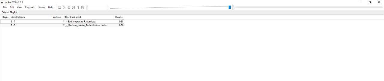

@naim lascia perdere il telefono, guarda anche il DR Log, corrisponde ai dati forniti da @ilmisuratore
Cita
foobar2000 2.1 / Dynamic Range Meter 1.1.1
log date: 2024-03-20 02:01:34
Statistics for: ?-11 - Barbaro partiro Radamisto
Number of samples: 1812812
Duration: 0:38
                 Left              Right
Peak Value:     -4.00 dB   ---     -4.02 dB
Avg RMS:       -20.45 dB   ---    -21.38 dB
DR channel:     12.80 dB   ---     13.70 dB
Official DR Value: DR13
Samplerate:        48000 Hz
Channels:          2
Bits per sample:   24
Bitrate:           2304 kbps
Codec:             PCM
Cita
log date: 2024-03-20 02:03:55
Statistics for: ?-11_-_Barbaro_partiro_Radamisto secondo
Number of samples: 1812349
Duration: 0:38
                 Left              Right
Peak Value:     -3.97 dB   ---     -4.04 dB
Avg RMS:       -20.43 dB   ---    -21.38 dB
DR channel:     12.82 dB   ---     13.68 dB
Channels:          2
Bits per sample:   24
Bitrate:           2304 kbps
Codec:             PCM
https://melius.club/topic/19165-test-di-ascolto-i-nostri-giudizi-sono-unanimi/page/12/#findComment-1146230
