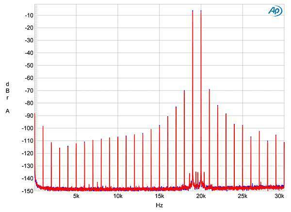

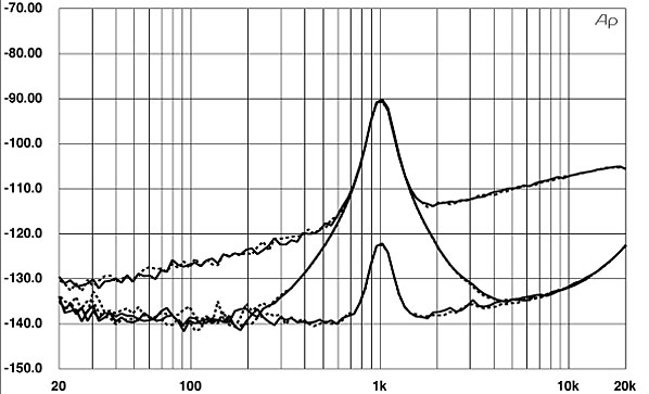

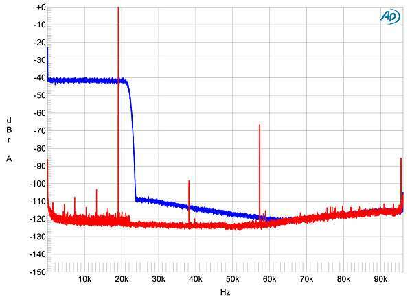

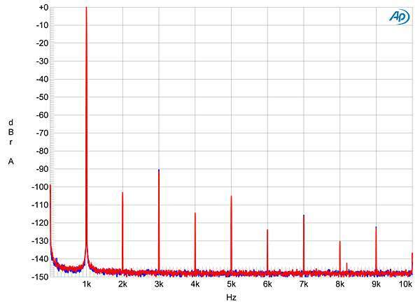

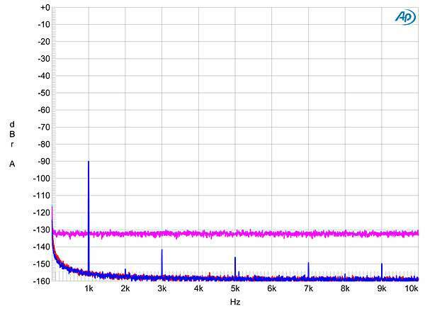

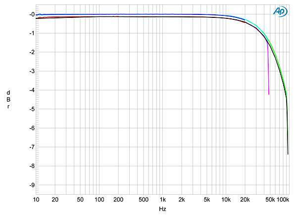

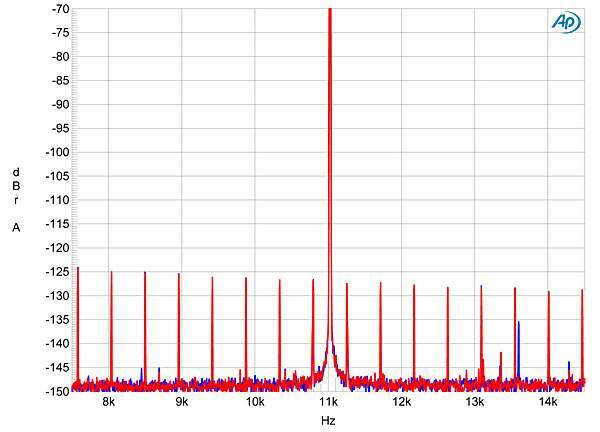

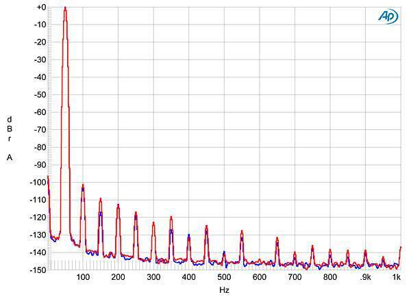

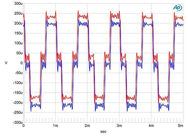

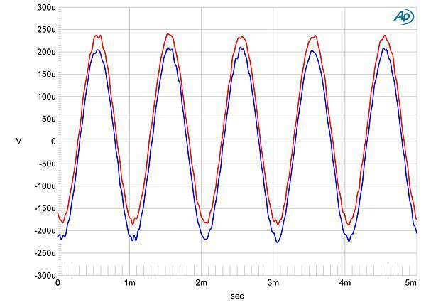

GasVanTar Inviato 10 Maggio Inviato 10 Maggio Guardate come suona questo dac; non è una provocazione: è solo curiosità del sottoscritto che non capisce un acca di grafici e misure. Non scrivo marca, costo e data di nascita dell'oggetto così da non creare pregiudizi. Lo comprereste a scatola chiusa? Fig. 1 - frequency response at –12dBFS into 100k ohms with data sampled at: 44.1kHz (left channel blue, right red), 96kHz (left cyan, right magenta), 192kHz (left green, right gray) (1dB/vertical div.) Fig. 2 - wideband spectrum of white noise at –4dBFS (left channel blue, right magenta) and 19.1kHz tone at 0dBFS (left cyan, right red), with data sampled at 44.1kHz (20dB/vertical div.) Fig. 3 - 1/3-octave spectrum with noise and spuriae of dithered 1kHz tone at –90dBFS with 16-bit data (top) and 24-bit data (middle), and at –120dBFS with 24-bit data (bottom) (right channel dashed) Fig. 4 - spectrum with noise and spuriae of dithered 1kHz tone at –90dBFS with: 16-bit data (left channel cyan, right magenta), 24-bit data (left blue, right red) (20dB/vertical div.) Fig. 5 - waveform of undithered 1kHz sinewave at –90.31dBFS, 16-bit data (left channel blue, right red) Fig. 6 - waveform of undithered 1kHz sinewave at –90.31dBFS, 24-bit data (left channel blue, right red) Fig. 7 - spectrum of 50Hz sinewave, DC–1kHz, at 0dBFS into 100k ohms (left channel blue, right red; linear frequency scale) Fig. 8 - spectrum of 1kHz sinewave, DC–10kHz, at 0dBFS into 100k ohms (left channel blue, right red; linear frequency scale) Fig. 9 - HF intermodulation spectrum, DC–30kHz, 19+20kHz at 0dBFS into 100k ohms, 96kHz data (left channel blue, right red; linear frequency scale) Fig. 10 - high-resolution jitter spectrum of analog output signal, 11.025kHz at –6dBFS, sampled at 44.1kHz with LSB toggled at 229Hz: 16-bit data via USB from MacBook Pro (left channel blue, right red). Center frequency of trace, 11.025kHz; frequency range, ±3.5kHz Fig. 11 - high-resolution jitter spectrum of analog output signal, 11.025kHz at –6dBFS, sampled at 44.1kHz with LSB toggled at 229Hz: 24-bit data via USB from MacBook Pro (left channel blue, right red). Center frequency of trace, 11.025kHz; frequency range, ±3.5kHz
ilmisuratore Inviato 10 Maggio Inviato 10 Maggio Manca una misura maggiormente interpretativa a livello di segnali musicali, la distorsione multitono integrale...di cui mi aspetto risulti piuttosto altina in quanto c'è una terza armonica dominante con ampiezza piuttosto elevata e una corposa distorsione da intermodulazione ad alta frequenza La parte digitale non è male in quanto ricostruisce correttamente i 3 livelli sui segnali a 16 bit e la sinusoide a 24 bit...ma lo stadio analogico tende a distorcere oltre una certa soglia Vediamo se alla fine possiamo associare anche la distorsione integrale Mi aspetto uno di quei DAC che tendono a colorare il suono, non degradarlo...nessuno commercializza DAC che distorcono...ma l'apparecchio è caratterizzato

ilmisuratore Inviato 10 Maggio Inviato 10 Maggio 12 minuti fa, GasVanTar ha scritto: L'altra misura cosa avrebbe determinato in aggiunta a quello che c'è già? L'altra misura avrebbe dato conferma a quello che s'intravede come "rampa di lancio" circoscrivibile alle misure che hai postato, ma lo avrebbe fatto con un segnale strutturato per assomigliare molto all'inviluppo dei segnali musicali Con la coppia di toni 19+20kHz at 0dBFS si nota che lo stadio analogico tende a produrre prodotti da intermodulazione Con il grafico classico della distorsione armonica che lo precede l'ampiezza tende a salire attorno i -90 dB di terza armonica Se prendessimo come riferimento il solo segnale sinusoidale puro potremmo concludere che questa distorsione non si riesca a sentire...tuttavia quando è presente distorsione armonica (fino a determinati livelli) si manifesta anche distorsione da intermodulazione, per cui con i multitoni si forma un tappeto "erboso" che contiene tutti i prodotti dell'intermodulazione sommati alla componente di rumore Da questa misura si stabilisce con maggiore precisione se l'apparecchio valica la soglia della neutralità spostando le caratteristiche verso un suono "edulcorato" da prodotti spuri che non fanno parte dello stimolo originale, ma aggiunti dalle caratteristiche dell'elettronica Ci sarebbero anche altre misure (che nessuno pubblicizza) relative al comportamento dello stadio di alimentazione, poterne capire il corretto dimensionamento, se c'è propagazione asimmetrica DC offset nel segnale, il comportamento nella fase transitoria dei segnali ad elevato tempo di salita, l'ADSR, e come reagisce ai segnali impulsivi spalmati in unità temporale molto stretta o quantomeno entro i tempi d'integrazione del nostro udito Quelle che solitamente vediamo sono misure nel dominio della frequenza, le cui indicazioni sono piuttosto buone...ma non è che una rivista possa impiegare molto tempo per dedicarsi in modo certosino e completare per ogni singolo apparecchio un quadro completissimo, non ce la farebbero...e manco gli converrebbe in termini di ritorni economici 1
