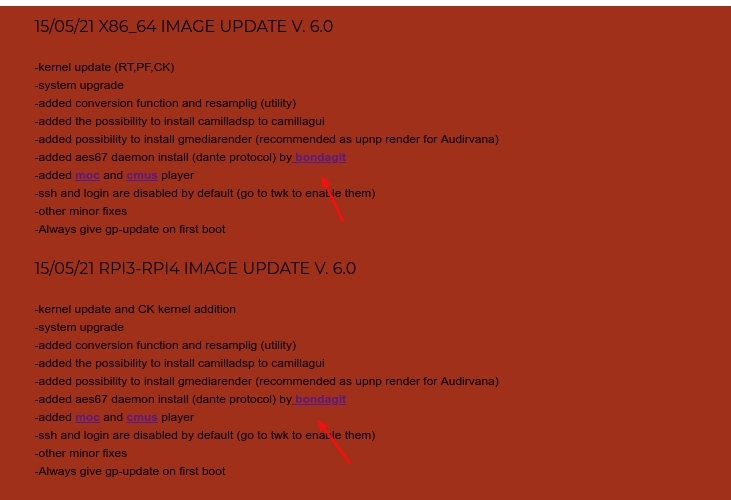

antonellocaroli Inviato 24 Maggio 2021 Condividi Inviato 24 Maggio 2021 se qualcuno se le fosse perse: x86_64 IMAGE UPDATE V. 6.0 -kernel update (RT,PF,CK) -system upgrade -added conversion function and resamplig (utility) -added the possibility to install camilladsp to camillagui -added possibility to install gmediarender (recommended as upnp render for Audirvana) -added aes67 daemon install (dante protocol) -added moc and cmus player -ssh and login are disabled by default (go to twk to enable them) -other minor fixes -Always give gp-update on first boot RPI3-RPI4 IMAGE UPDATE V. 6.0 -kernel update and CK kernel addition -system upgrade -added conversion function and resamplig (utility) -added the possibility to install camilladsp to camillagui -added possibility to install gmediarender (recommended as upnp render for Audirvana) -added aes67 daemon install (dante protocol) -added moc and cmus player -ssh and login are disabled by default (go to twk to enable them) -other minor fixes -Always give gp-update on first boot Link al commento https://melius.club/topic/638-gentooplayer/page/8/#findComment-95577 Condividi su altri siti Altre opzioni di condivisione...
