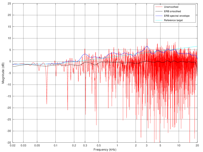

Ecco qui Fabio
Rappresentazione della risposta no smoothing e con filtri di "smussatura" applicati
E' chiaro che se lo spettro in rosso lo porti flat, ne consegue una linea "smussed" con andamento calante
Certamente dipenderà da ogni contesto acustico, del relativo campo diffuso, ma il concetto è (era) questo

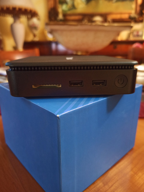

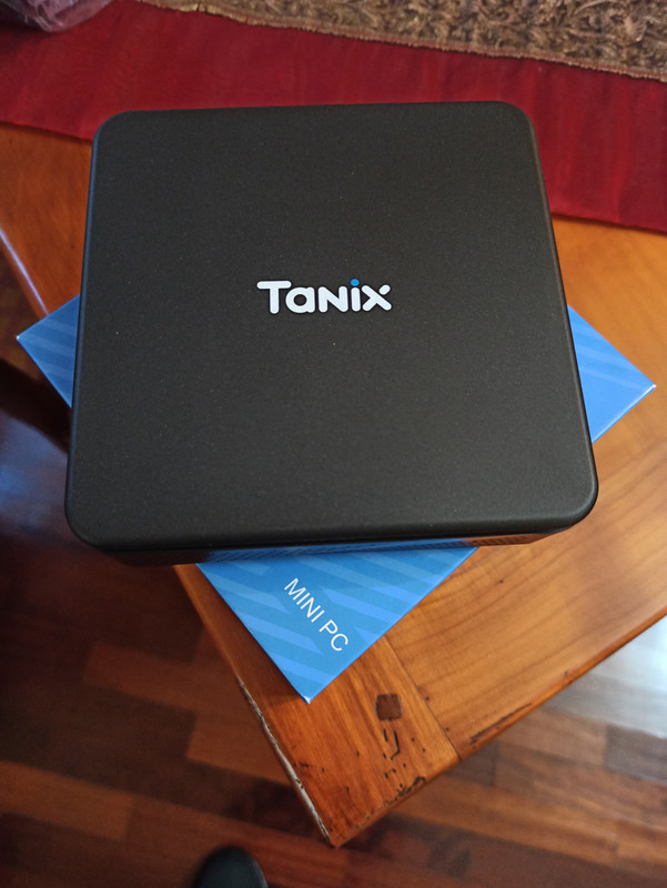

Arrivato in questo momento il mini pc
Chiedo all'opener del 3D (Bunker) se è il caso di descrivere qui le caratteristiche, o se conviene aprire un 3D a parte
Immagino possa appartenere all'hardware per l'implementazione del DRC con foobar ???

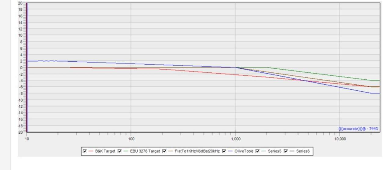

Ok ma:
Su questo che mi dici?
In 1974, Bruel and Kjaer instruments wrote an application note on, "Relevant loudspeaker tests in studios in
Hi-Fi dealers' demo rooms in the home etc. using 1/3 octave, pink-weighted, random noise." See Figure 5:
"The optimum curve for HIFI equipment measured in the actual listening room." While the curve is smooth, it
does have a gradual roll-off. Looking at the frequency response plot, the gradual roll-off starts at -0.5 dB at
200 Hz, -3 dB at 2 kHz, and -6 dB down at 20 kHz. Over time, this became known as the B&K "house
curve." For decades, professionals and amateurs alike have used the B&K house curve (or target response)
when equalizing a sound reproduction system for critical listening purposes.
In 2009, Dr. Sean Olive from Harmon wrote a paper on, "The Subjective and Objective Evaluation of Room
Correction Products." Presentation download. Through the use of measurements and listening tests, the
preferred response is a straight line, but tilted starting at +2 dB at 20 Hz to -8 dB at 20 kHz. The conclusion
is that flat in-room response is not the preferred target response.
In 2015, Dr. Floyd Toole wrote an AES open access paper on, "The Measurement and Calibration of Sound
Reproducing Systems." See Figure 14 "Subjectively preferred steady-state room curve targets in a typical
domestic listening room [49], from Olive et al. [48]. The prediction of Fig. 13(a) is superimposed." Note that
the trained listener's preference target curve is similar to the other targets referenced above.
Overlaying the "house curves" or target responses:https://www.audiosciencereview.com/forum/index.php?threads/what-is-your-favorite-house-curve.2382/page-2
Cioè
Di fatto le target curve preferite sono calanti
Anche la tua preferita, presa nelle stesse condizioni, diventa calante?
Se no, perché?
Cioè in pratica,  se io ti dico che preferisco una cosa più  o meno simile a questa:
Sei d'accordo o no?
Pls, dicci tutto del minipc
Siamo tuttorecchi
Non sono l'opener ma ti autorizzo lo stesso....:classic_smile:
Soprattutto...va bene per roba tipo 24/96 e tonnellate di convoluzioni e plugin?
