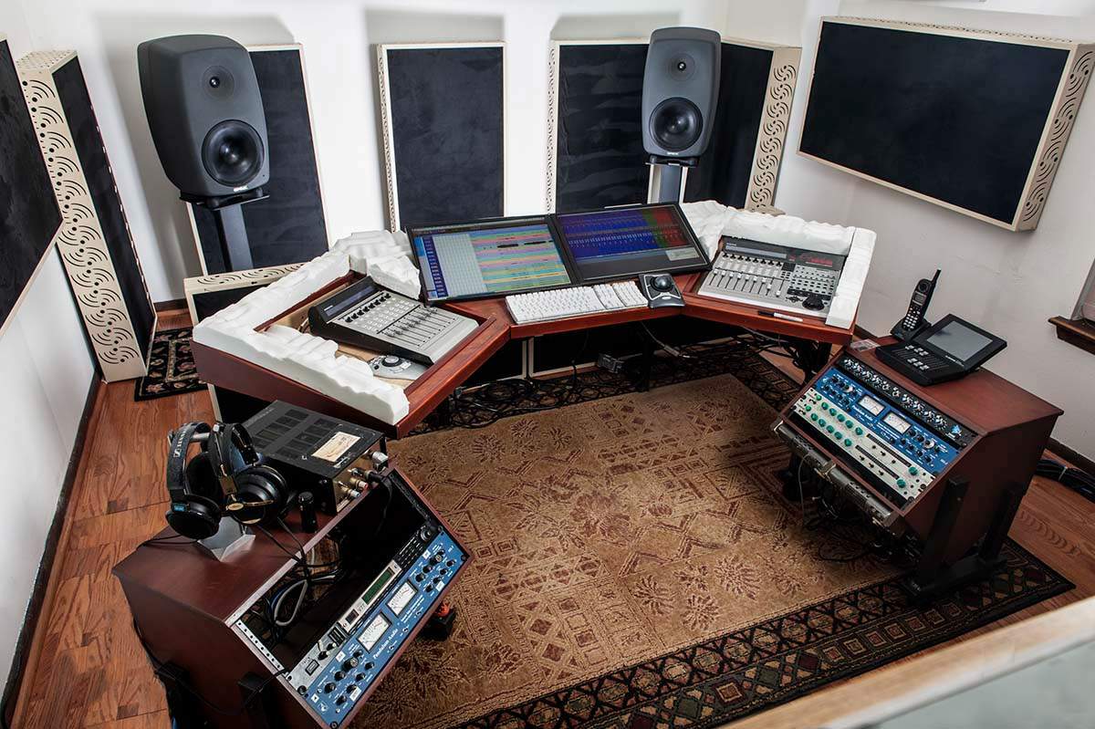

Ah: uno a caso lo studio B di Bob Katz citato da  @fabrizio
Studio B serves two purposes: It is our mixing room. It is also the proofing room and preparation room for all masters. Masters are proofed and cleaned here with the Sequoia DAW before Bob begins mastering in Studio A, so Bob can be fully engrossed in your music when he is mastering. Studio B’s loudspeakers (the first pair of Genelec 8260‘s in the United States) give crystal-clear audiophile sound because of their unique 3-way design, and careful calibration through the Genelec GLM Software with our master chef’s “special ingredients”. This DSP-controlled interface provides a way of ameliorating any problem areas in the room after acoustic treatment has been done, giving a flatter response at the listening position. For mixing we employ Pro Tools HD (version 11 or 12), running on an 8-core MacPro with Mytek Converters. Sample-rate conversion is done through the high-quality program Saracon, by Weiss. Outboard analog and digital gear from Bricasti, Pendulum, Cranesong, API, Millennia, DBX, TC (System 6000 and Powercore), and UAD are used for mixing. Along with plugins from Audioease, PSP, Waves and many others. Monitoring is controlled with a high-resolution TC Electronic BMC-2.
Per inciso è esattamente quello che ho fatto io nella mia stanza, da tempo, oltre che, naturalmente tutti gli accorgimenti a monte (fasi, posizionamento degli apparecchi e dei diffusori, qualità delle alimentazioni). Quella qua sotto è la mastering room B di Bob Katz

A proposito di Bob Katz,  probabilmente secondo qualcuno un tizio rimasto all'audio degli anni '70...ecco quello che pensa del DSP, quello fatto come si deve:
This is my enthusiastic recommendation for AudioVero's Acourate Digital Room and loudspeaker correction system (abbreviated "DRC" for Digital Room Correction). Up until recently I have been thoroughly disappointed in the sound quality of purported DRC systems. I concluded that no correction was better than the sonic results of an inferior DRC system. Up until a few years ago, none of them met their promise. Among the symptoms: Loss of transparency. Overcorrection (over equalization). Transient response degradation. Loss of headroom (maximum SPL without distortion). Fuzzy and inexact imaging. I can go on, but the bottom line is I was disappointed.
Then I discovered AudioVero's Acourate. Acourate is the first DRC that I can thoroughly recommend. The resulting sound is unquestionably equal or superior to the uncorrected loudspeaker in all respects: Transparency is equal, there is no perceived loss with Acourate. It is truly an audiophile-quality system that even die-hard audiophiles and analogphiles need not be afraid of. Everything else about Acourate makes the corrected loudspeaker sound superior: Stereo imaging and soundstage are more exact and the sweet spot in the center is effectively widened. Tonality is greatly improved and the frequency response extends perceptually flat from 20 to 20 kHz. Transient impact is superior and there is no loss of headroom and no perceived noise, when the gain staging is done correctly. Some of the technical reasons for Acourate's superiority: 64-bit calculation throughout, properly dithered to 24-bits at the end of the chain; no degrading ASRC circuit, the sample rate that goes out is the same as what comes in. No overcorrection, a unique breakthrough in psychoacoustic analysis beats any previous third- or sixth- octave techniques for estimation of the audible effect of the room and loudspeaker combination, and a variable calculation window ensures accurate frequency response. For the first time with any correction system, I felt no need to change or tweak any filters or add any filters to the circuit. Superior target design, this is the most ergonomic part of the program and allowed me to zero in on the ideal high frequency rolloff for my system in a very short time. I haven't found need to change the target since the first day I designed it. Superior impulse response and phase response. Superior crossover implementation, linear phase and with the most accurate curve. Basically, they do everything right and I've only scratched the surface in this description of its superior abilities. Superior to any other DRC I have used or tested.
If you have any questions about this endorsement, which I give honestly and with no compensation, by all means contact me at
bobkatz[at sign]digido.com.
Lo so che non c'è alcuna speranza di far passare questo tipo di messaggio in hiend,  semplicemente perché  non conviene a troppi,
Sposterebbe preziose risorse dove i miglioramenti si ottengono in modo dimostrabile
Peccato mortale in hiend,  ahimè, o così spesso mi pare venga considerato
Sarà anche lui uno rimasto agli anni '70?
