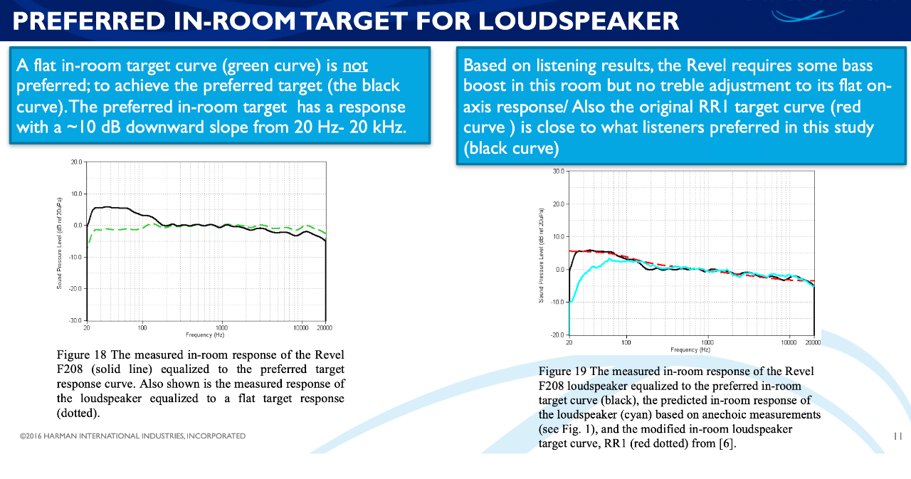

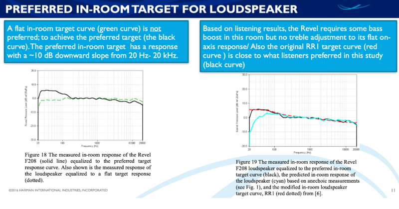

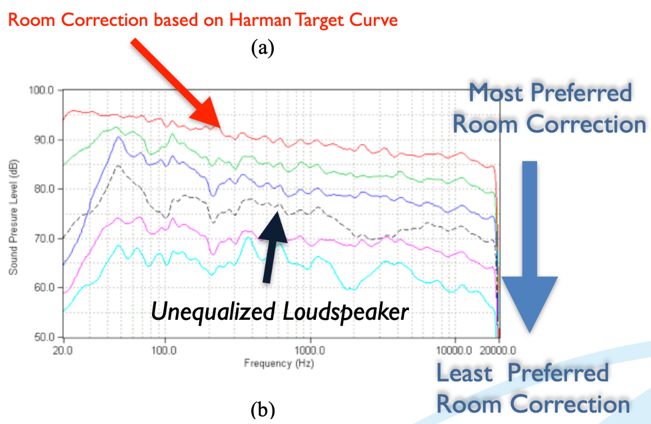

C'è il famoso studio di H&K.
"In this paper we reported experiments where trained listeners evaluated two different headphones (Sennheiser HD 518 and Audeze LCD-2) unequalized and equalized to different target curves (diffuse, modified diffuse, free-field) and two Harman target curves based on the equalized in-room response of a loudspeaker"
CONCLUSIONS
The preferred Harman headphone target response closely matches the preferred in-room response of an accurate loudspeaker in a reference listening room having about a 10 dB downward slope from 20 Hz-20 kHz
The preferred headphone target shape may vary depending on several factors:
• the spectrum and balance of the recording (circle of confusion issues)
• listeners’ age, listening experience: younger, less experienced listeners tend to prefer more bass and treble; older listeners may prefer more treble to compensate for hearing loss
• individual taste
• bass loss due to leakage/fit (closed headphones and IE types)
• masking of bass/mids from background noise

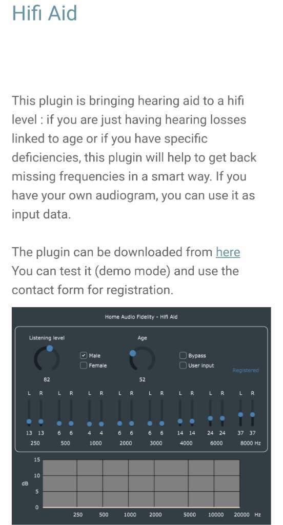

Io non sarei nemmeno contrario, se ben implementata, ad una correzione che vada a compensare il deficit fisiologico delle alte frequenze col procedere dell'età. Non so però un audiofilo âgée con le Golden ears come la vivrebbe... :classic_biggrin:

Inviato
A chi interessa posso consigliare questa chicca
Volendo potete impostare i vostri parametri
Ma per chi ha più di venti anni e un udito normalmente degradante con l' avanzare dell' età, va benissimo ed è molto semplice da usare
PLUGINS - Home Audio Fidelity https://share.google/0Nws4g8kL5Sh8ckJl
