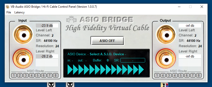

ilmisuratore Inviato 2 Giugno Inviato 2 Giugno VB-CABLE standard is not bit-perfect. Because it acts as a multiformat virtual driver, it uses internal Sample Rate Conversion (SRC) to process and route audio between inputs and outputs, which alters the original data stream. [1, 2] Why it's not bit-perfect To make a standard VB-CABLE work across different applications, it resamples the audio to a fixed internal format (unless input and output sample rates perfectly align in its settings). This makes it great for gaming, streaming, and general use, but undesirable for audiophiles looking to preserve 100% of lossless audio data. [1, 2] The bit-perfect alternative If you need bit-perfect audio routing, VB-Audio offers VB-Audio Hi-Fi Cable. [1, 2, 3] Bypasses Windows Mixer: It doesn't use the standard Windows resampling stack, ensuring the original bitstream reaches your audio software. High-Res Support: It is capable of supporting streams up to \(24 \text{ bits } / \text{ } 384 \text{ kHz}\). Requirements: Input and output devices must be configured to the exact same sample rate to maintain the bit-perfect stream. [1, 2, 3] 1
ilmisuratore Inviato 2 Giugno Inviato 2 Giugno ...non viene riportata compatibilità con i sistemi win 10...io l'ho installata e la schermata compare Vediamo se questo funge
